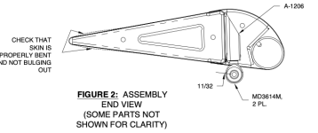

Helping a builder with Phase 1, slight left wing heavy. Looking and TE bend radius all looks good except two bays (about 6" each) on left Flaparon. If it were to decrease bend radius more it would make the left wing heavier. Right now we are doing nothing. Van says this is normal and on their S-LSA they typically have to do some tweak's. Plane is well built and fly's well, book specs. Eventually want to fine tune this (without over dooing it).
My question is how difficult is it to get at the mxing links? What do you suggest in how to adjust.
Looking at the TE alignment there looks to be some out of alignment or rig (slight). But it also seems to be opposite of what I'd expect for slight LEFT wing heavy. Again the condition is minor, but noticeable. I don't want to increase or make the issue worse.
Increasing the RIGHT Flaperon TE radius is not an option as that one has perfect bend radius and any more would be over done.
BTW I am a TE expert, in that I mean 25yrs ago with my RV-4 I over did the aileron TE bend and ended up reskinning one aileron. I know to be very careful, make tiny incremental changes between flight test.
May be leave it alone? The plane has two 180 lb pilots, full to half fuel. As I said it flys nice but not hands off. May be this is an RV-12iS thing and chasing this down to the Nth degree of roll perfection is not needed or possible?

Before doing anything too drastic I would simply check the extension of the flaperon bearings. The flaperons are huge and the 11/32" dimension should be exact on all the bearings.
Agree with Tony_T. If you fiddle with the linkages/mixer, all you will do is change where the stick will naturally point with no pressure. It won't change how the plane flies. I found that making a full rotation on the outboard bearing and a half rotation on the inbound bearing nicely balanced my heavy wing. Unfortunately, I don't recall if I raised/lowered the bearings and I don't recall if I adjusted the heavy or light wing. Luckily, it's an easy process to reverse if you discover you adjusted the wrong way on the first guess.
I ended up with a plane that is slightly Left heavy solo and slightly R heavy with a passenger. I think that's as close to perfect as you can get without dynamic roll trim. Good luck and fly safe.
Apply a small trim wedge to one of the flaparons? Putting it on the underside of the 'light' flaparon would make it less obvious visually.

I edited my original post. We went flying today, Got a better look at the Left and Right Flaperons. The Right flaperon is ever so slightly (1/16" to 3/32") lower (more lift) relative to wingtip trailing edge, when the Left Flaperon is aligned with wing tip. That would explain the left wing heavy, or right wing light. Again the roll is slight. I will pass on this information and help builder sort it out.
May play with the trim wedge with double sided sticky just to see the effect and as a temporary fix. I like to use balsa wood with some paint and double sided sticky tape or a temporary trim tab. They are light, shaped easy and also easy to remove later.

Have a look at the PAP documentation. It calls for you to hold the left flaperon in trail and the right flaperon should be slightly low,
3/16 is a number that sticks in my mind. I don’t have it handy, so check my work. My memory does not come with a guarantee.
hope this helps
Cheers DaveH
As Daveyator indicated the flaperons do droop & the amount is verified during the PAP. They should have been rigged with 1/8th inch low on both sides during build. The tensiometer is used to set the tension in the cables & the PAP asks you to verify no slap when you jerk the stick around.

I have a slightly heavy left wing too. I reduced it some by verifying 'flatness' of the top skin aft of the rear spar. Set a straight edge on the top skin and verify that it does not bend up or down aft of the spar. This had more effect than trailing edge adjustment although I will admit I applied a very light touch with that. Next on the list for will be making the rod end adjustment, but I'm not in a huge rush to do that based on following the same advice you have referenced from Van's. There is no real stick pressure necessary to remove the roll, natural resting position of the hand is enough. The airplane flies like a dream.
